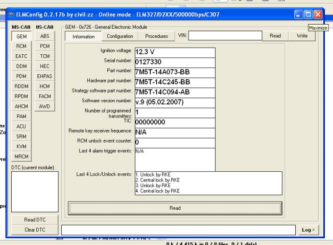

Before buying any parts there is few things to check:
1. GEM number – according to info I have it must end with DX (where X could be any letter - A,B or any other), for example 4M5T-14A073-DW. I have read about another person who has successfully added Cruise Control to their Ford with a "C" GEM, but it was only one case and I am not 100% sure about it. You can read the GEM number on the sticker on the other side of fuse box.
Kod mene je sa oznakom C
